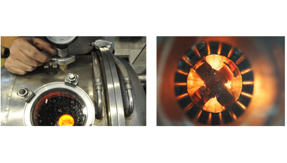

In a second step, the actual performance targets in the project, such as corrosion, H2 embrittlement and wear/mechanical damage, as well as microstructural characteristics of the alloys will be evaluated and collected in a database to further train the ML model. To construct this database with advanced properties, two complementary CCA preparation routes routes will be applied. As mentioned above, partner OCAS is carrying out small-scale induction melting while partner EMPA will apply combinatorial PVD. Induction melting allows the screening of a variety of different elements; combinations of three to six elements are being tested from a pool of 14 different ones.

Although OCAS has a long tradition in induction melting and casting ferrous and several non-ferrous alloys, melting CCAs adds to the challenge. In fact, elements are not only present in large quantities in CCAs but several of them, such as Ti, Cr, V having melting points around 1900°C and elements such as Nb, Mo, Ta, W having melting points in the range of 2500 up to 3600°C, also possess high or even ultra-high melting points.
Moreover, some elements such as Ti, are very reactive to most crucibles. To avoid time-consuming iterations in a high-throughput flow, anticipating the selection of raw materials or pre-alloys and crucibles is crucial.

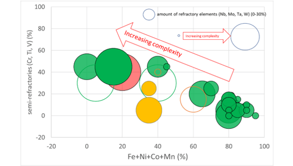

Currently, 30 alloys have been synthetized, the majority via induction melting in quantities of approximately 0.5 kg each. The graph below highlights their success rate versus their complexity in induction melting. As one alloy failed upon casting via induction due to too strong interaction with the crucible (red), four other alloys were cast via arc melting (open circles). Four alloys (orange) broke upon solidification, most likely due to their inherent brittleness, not being able to accommodate the thermal strains upon cooling.

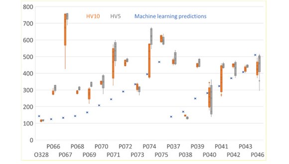

Hardness in the as-cast condition was already measured at OCAS for 19 alloys and the results were compared to the ML model predictions. The agreement depends strongly on representation of the alloy family in the database used to train the ML model. A good agreement was found for the largely represented alloys, whereas alloys with a very limited representation showed large deviations.
Despite the huge number of available hardness values in literature for HEA and CCA, the need for a fast way to provide experimental data remains to support databases and machine learning models.
