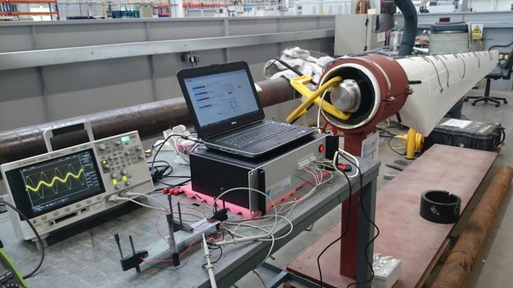

Figure 1 Prototype UGW and LFV controller system developed during the project

Having identified the main parameters required, the consortium also designed and built the UGW and LFV control system.
The system was designed to operate at temperatures down to -20°C and tested as low as -30°C. The completed prototype system was assessed both in the laboratory and in a wind tunnel as part of the capability validation process.

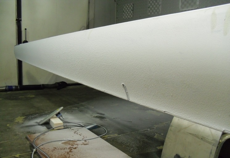

To demonstrate the newly developed technology and the performance of the system, the DeICE-UT team carried out a campaign of tests in an environmental testing chamber at HORIBA MIRA (formerly the Motor Industry Research Association). For this purpose they prepared two types of test piece: a section of a full-scale wind turbine blade (to validate the LFV) and a small-scale mock-up (to validate the leading-edge UGW). During this test campaign the researchers were able to check the performance of the system for different types of ice formation, confirming the effectiveness of these two technologies and the capabilities of the DeICE-UT system.

Figure 2 Ice formation on mock-up blade – prototype system validations, HORIBA MIRA climatic chamber
