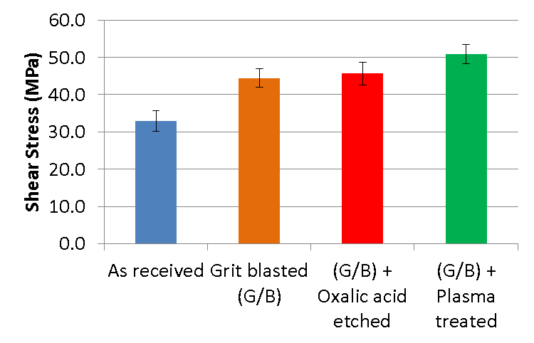

This project, part of TWI’s Core Research Programme, aims to reduce the dependence on wet chemical processes as a pre-treatment to adhesive bonding of metals by replacing the etching chemicals with cold atmospheric plasma (Figure 1). This process successfully increased the lap shear strength of 316 stainless steel from 33 MPa (untreated) and 44 MPa (grit blasted)  to 51 MPa (grit blasted and CAP treated), while a grit blasted and acid etched joint failed at 46 MPa (Figure 2). This was achieved while maintaining the joint’s mechanical properties and limiting the use of wet chemicals to solvent degreasing only

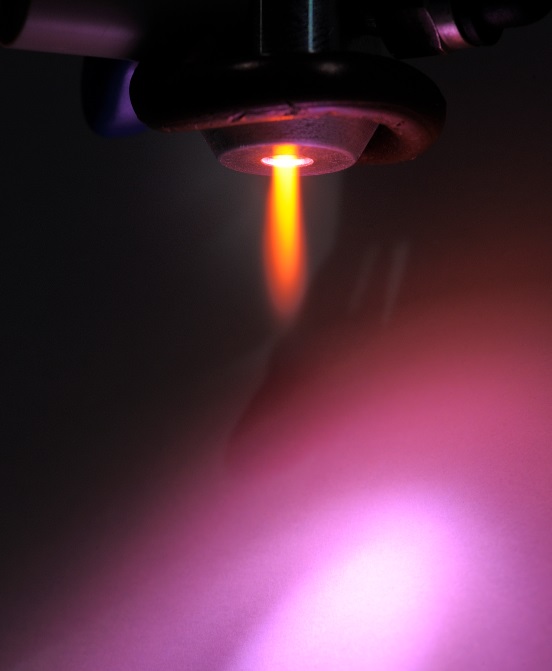

Figure 1 Helium:nitrogen plasma plume

Initial testing performed using 316 stainless steel as a substrate increased the bond strength while maintaining durability. Initial analysis of titanium-6Al-4V is underway, with early results suggesting CAP has produced a bond strength 93% as strong as chemical etching; this data will be refined during the remainder of the project, which is due to end in September 2017. Chemical analysis of the plasma plume and how it affects the surface is also ongoing.

Figure 2 Lap shear results for 316 stainless steel
