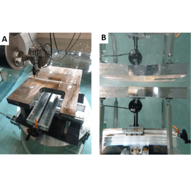

Figure 1. Ultrasonic beam fingerprint experimental setup on a welded component

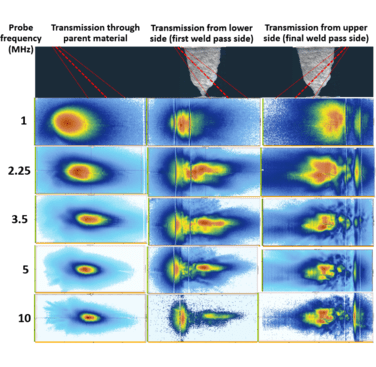

A methodology was established to allow consistent signal-to-noise (SNR) analysis and ultrasonic beam analysis. Each weld specimen went through an extensive set of experiments, including a through transmission hydrophone setup, which allowed for the mapping of the ultrasonic beam after transmission through the weld. Figure 1 shows the setup used to undertake the fingerprint of the welded specimens. Figure 2 shows an example of the ultrasonic beams recorded after transmission through the weld at different sound frequencies.

A methodology was established to characterise the austenitic welds with regards to noise analysis, through transmission beamplot generation and defect inspection in representative specimens. The beamplot analysis showed that ultrasonic beam at the recommended low frequency still presents beam splitting where the major part of the ultrasonic energy propagates downwards towards the weld root. This effect is more pronounced for weld fabricated in vertical upwards (PA) and downhand positions (PF). The noise analysis of the welds showed that the welding position described as vertical/horizontal (PC) presented a significant difference due to the large amount of cross sectional asymmetry in the grain structure. Taking into account the difference in terms of efficient SNR and sizing accuracy between frequencies ranking from 2MHz to 5MHz, it is recommended that different inspection techniques are used for comprehensive detection and sizing capabilities.
Figure 2. Results of the ultrasonic beam fingerprint
