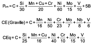

Further development of Carbon equivalent formulae has taken place and several can be found in technical literature today. Three of the more common ones are Pcm, CEq and CEN. Ito and Bessyo [5] developed Pcm in Japan based on a wider range of steels than the IIW formula:
The CEq formula devised by Düren [6] has a similar appearance:
Both the Pcm and the CEq formulae were developed for low carbon steels for which the CEIIW is less suitable. Pcm is generally used for modern steels typically used for pipeline manufacture, where carbon contents are no more than ~0.11 wt% [7] .
However, it should be noted that the Pcm formula was derived largely from lower C low alloy steels.
The CEN formula was proposed to evaluate the weldability of a wide variety of steels. For the higher C range, the values of CEN correlate well with carbon equivalents such as CEIIW, whereas for lower carbon steels the values are close to those of the CEq formula. CEN is given by:
Yurioka [8] illustrated a good correlation between Pcm and CEN for structural steels, low-alloy steels (Ni-Cr-Mo type) and carbon steels, provided the carbon content was less than 0.17 wt%. From this comparison the following relationship was derived:
CEN = 2P cm - 0.092 (C ≤ 0.17%)
