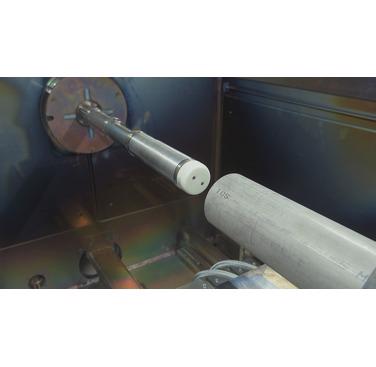

The EBOBend apparatus enables the electron beam to access the inside of tubes or cavities for EB processing.
This is accomplished by deflecting the beam through a small 90° arc via a specially designed electromagnet and control system.
The EBOBend equipment makes welding and processing possible at the full power of the machine, facilitating welds up to and beyond 20mm in titanium.

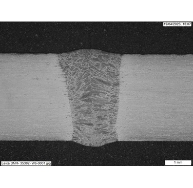

The first phase of the programme was to demonstrate a circumferential melt run on the inside diameter of a NPS 4 Schedule 10 duplex pipe.
After a short development programme, the resulting weld was of high quality and the interior weld profile much better than that which could have been achieved in a standard EB system.

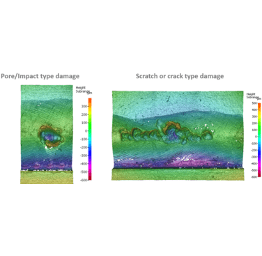

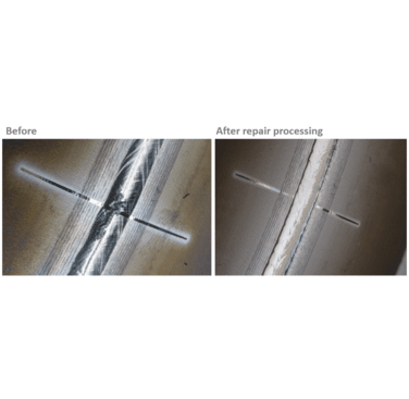

In this series of experiments simulated defects were introduced into a welded 1.3GHz niobium cavity using a vibro-etching tool. The damage was purposely made larger than normal to show the capabilities of the process.
A series of repair tests were performed and the results showed a complete removal of the defect, leaving a smooth weld root with a smaller profile than the original weld.

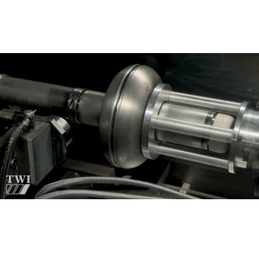

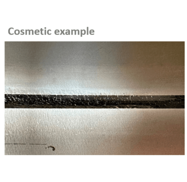

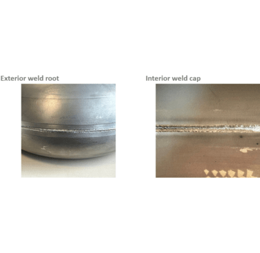

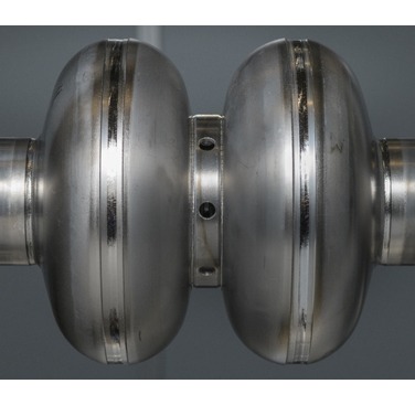

A further phase of the programme explored the prospect of welding the final equator joint in the hemisphere/dumbbell assemblies. Traditionally, the final joint in the assembly of cavity structures is the equator weld on the hemispheres. This joint is welded using a tightly controlled process with higher vacuum and increased cleanliness than normal EB welding. This is done to avoid degrading the superconducting performance of the niobium via contamination during welding.
These welds must also be smooth on the interior and must not protrude heavily [<250µm] into the cavity, as these features impact their performance. Welding from the inside opens up several opportunities to change the traditional welding process. Thicker material can be welded without the risk of excessive weld roots, cosmetic weld passes can be made to further improve the weld smoothness and reduce any abnormal profiles.
Current results from a series of experiments show that excellent results can be obtained in ~3mm thick material. The full penetration weld made from the inside is extremely smooth after the cosmetic pass and, compared to the standard weld process, is of lower overall heat input. This will have additional benefits in reducing the size of the HAZ and minimising distortion.

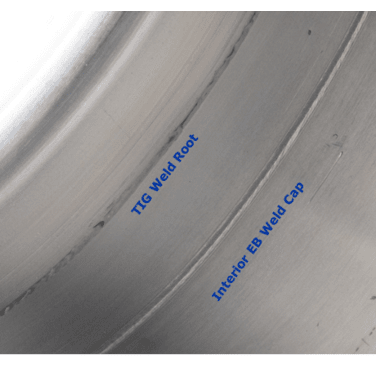

One hot topic area that TWI has worked on recently is that of electron beam welding aerospace components, namely, fuel tanks for satellite systems and novel construction methods for landing gear applications. Both of these areas could benefit from the increased access and internal processing that the EBOBend kit offers. Normally, inaccessible weld roots are not machined or dressed due to difficulties in accessing these areas. Possible options for processing these areas with the EBOBend equipment could improve the root profile, increasing fatigue performance of the joints and/or offering novel construction routes to otherwise complex items.

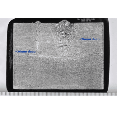

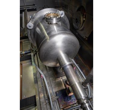

The final two demonstration welds in the programme were a large demonstration vacuum vessel, which is similar in size to current satellite fuel tanks, and a thick section titanium alloy weld to gauge the penetration achievable in initial trials.
A large scale 400mm diameter stainless steel vacuum vessel was sourced for internal welding trials. A 100mm diameter vacuum port was used to gain access to the interior of the vessel to perform a weld simulation for novel construction/modification of the vessel.
(You can see a video of the 'Large vacuum vessel welded from the inside out,' here.)
Figure 1. EBOBend equipment inside the EB vacuum chamber
Figure 2. Transverse weld macro of the inside out welded Duplex pipe

Figure 4. Scratch or crack type damage
Figure 5a. Before weld processing
Figure 5b. After weld processing
Figure 5a. Before weld processing Figure 5b. After weld processing
Figure 6. Electron beam welded twin cell demonstration SRF cavity
Figure 7a. Exterior weld root.
Figure 7b. Interior weld cap
Figure 7a. Exterior weld root. Figure 7b. Interior weld cap
Figure 7c. Cosmetic example
Figure 8. Large stainless vacuum vessel for internal welding trials
The results were notable, with smooth root and cap profiles across the full weld length. The system can be used not only to weld circumferential joints as performed here but, given the right access, it could be used to weld orbital joints of through penetrations as well.
Results from the thicker section titanium welds showed promise in that at least 20mm penetration can be achieved with only 40% of the power available [6kW].

Figure 9. Comparison of internal EB weld and conventional TIG welds
Figure 10. EBOBend welds in thick section titanium alloy
