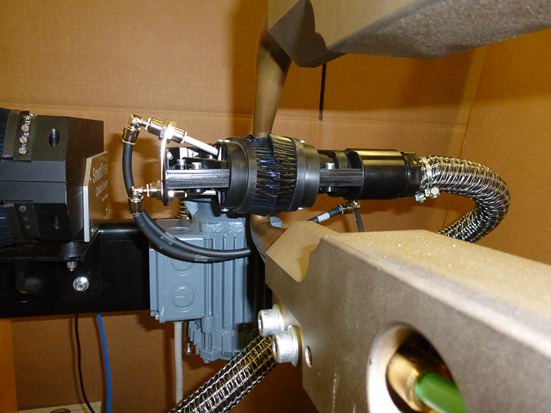

SmartDress is a new approach to electrode tip dressing comprising a complete automated solution to all the challenges faced when setting up and maintaining a resistance spot welding process.
The system incorporates five elements, including three totally new innovations: a new approach to electrode tip dressing, using an abrasive to clean electrode faces with a minimal removal of copper; an optical sensor to monitor the electrode condition; a computerised control system to process data from the optical sensor; a mechanical dresser designed to minimise copper removal during tip dressing; and an automated electrode tip changer, capable of removing worn tips and replacing them without the production cell needing to be shut down.
Problems with electrode tip maintenance are the number one cause of stoppages on car production lines, but SmartDress has the potential to change that. The system is currently being deployed at the Fiat-Chrysler plant in Melfi, Italy, where it is being used in the welding of the aluminium doors of the new Jeep Renegade.
