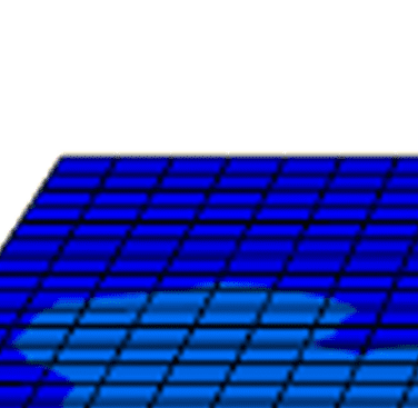

Multi-scale damage of a composite panel under ballistic impact

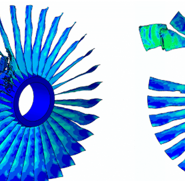

Foreign object damage of nickel-based
superalloy fan blades
Foreign object damage of nickel-based superalloy fan blades
