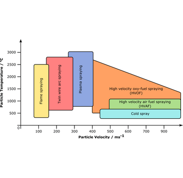

HVAF spraying is a ‘warm spray’ process that is cooler than HVOF, but hotter than cold spraying, enabling a wider range of materials to be sprayed. As with the other thermal spray processes, with the exception of cold spraying, the feedstock powder is melted but, in the case of HVAF, this occurs just above the melting temperature of the material, and lower than the vaporisation temperature (HVOF operates above the vaporisation temperature).

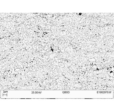

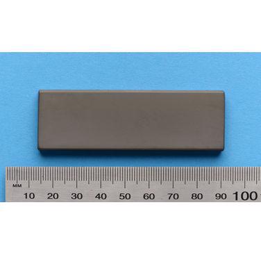

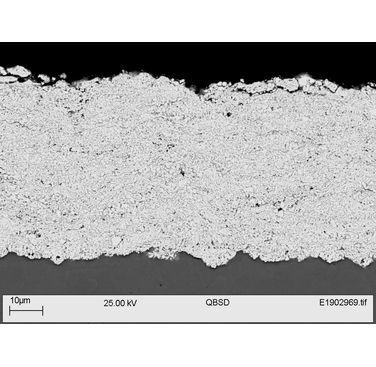

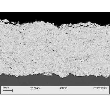

The application of thinner/denser HVAF ‘flash carbides’, already in limited use in industry with thicknesses ranging from 10-50µm, opens up cost/performance improvements over coatings produced using conventional HVOF spraying systems which are typically ~300µm thick. WC-CoCr HVAF coatings are claimed to offer comparable performance to electrolytic hard chrome plating. The deposited coatings are ~1400HV300 with an as-sprayed finish of ~1.5µm Ra, which is comparable to a typical ground surface finish, thus eliminating some of the post-spraying finishing costs. The use of thinner coatings also offers improvements in the fatigue debit over conventional HVOF hard chrome replacement coatings in demanding applications such as aircraft landing gear.
Cost savings are made with HVAF compared to HVOF WC-CoCr and Cr3C2-NiCr coatings, due to the use of less material and process gases, and the elimination of process steps, such as grit blasting and dimensional grinding post spraying. As with all thermal spray processes, HVAF coatings are applied directly to substrates without a heat affected zone, which offers significant benefits over fusion processes such as traditional weld overlays, plasma transferred arc (PTA) coatings, laser additive manufacturing processes and the extreme high-speed laser application (EHLA) process.
The use of air for HVAF spraying, rather than pure oxygen, reduces the oxide content of coatings compared with their HVOF equivalent. The lower flame temperature, typically ~1000°C lower than oxy-fuel combustion, also results in less thermal degradation of feedstock materials as particles are heated to just above their melting point. The combination of lower temperature and lower oxygen content in the combustion gas mixture helps to minimise oxidation of metal alloys and the decomposition or dissolution of carbides into metal binders in cermet coatings. As a result, the coatings can retain higher levels of ductility while maintaining high hardness levels. However, suppliers do offer combined HVAF/HVOF systems, which can operate in HVAF + HVOF mode to achieve a wide parameter window. For HVAF only systems, the requirement for bottled oxygen storage can be eliminated with the systems running entirely off of compressed air supplies.
Figure 1. Temperature / Particle Velocity for spray processes

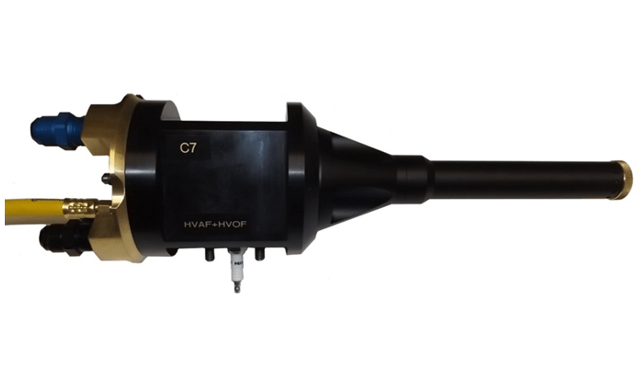

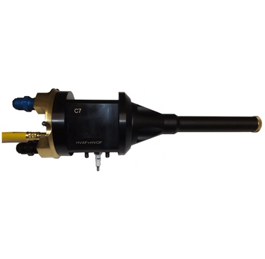

Figure 2. Kermetico C7 Convertible HVAF+HVOF Gun

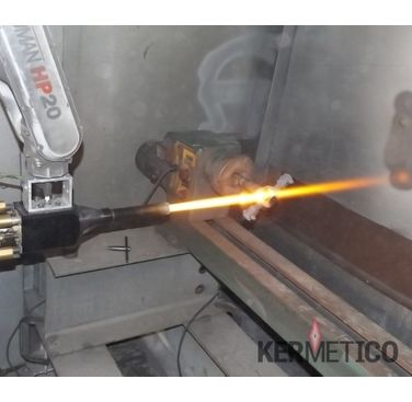

Figure 3.

Figure 4.

The gun design is also an important factor in the coating quality. The size of the combustion chamber allows a long residence time for heating of the spray particles. The gun design also enables particles to be accelerated to the gas velocity at 800-1000m.s-1. In this regard, the HVAF process offers some benefits similar to cold spraying technology, with high particle velocities and dense coatings, combined with minimal melting of the feedstock due lower combustion temperatures. As a result HVAF can deposit coatings that would be challenging to achieve with using cold spraying, such as materials with limited ductility or high volume fractions of ceramics.

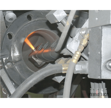

Two equipment suppliers offer HVAF spraying systems: Kermetico and UniqueCoat. Their product portfolios include a number of HVAF coating variants, including internal diameter spraying systems, which also open up opportunities for coating internal bores with a hard chrome plating alternative. This has been something that has proved to be challenging to date with traditional HVOF systems.
Applications for HVAF technology include those where hard chrome plating or HVOF coatings have traditionally been applied, including hydraulic rods and cylinders, aircraft landing gear and actuation systems, piston rings and valves, machinery parts, sliding and rotating shafts, automotive drive trains and suspension, tools and dies, and internal bores. HVAF coatings are also finding applications for protecting vessels against corrosion including in H2S environments, cavitation and erosion resistant coatings for pipework, fittings and valves, rollers for the steel and paper industries, along with hydroelectric components.
