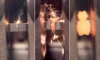

Linear friction welding has been demonstrated for virtually all types of engineering alloys, such as titanium ( Fig.1), steel, stainless steel, aluminium and inter-metallics, but the uptake of the process by industry has been impaired by the high capital cost of existing mechanical linear friction welding machines. Novel solutions have been devised to reduce the manufacturing cost of the equipment, mainly based around more efficient use of the power sources required and by use of stored energy concepts. This will lead to a very substantial reduction in equipment price.

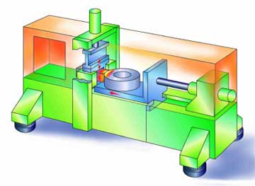

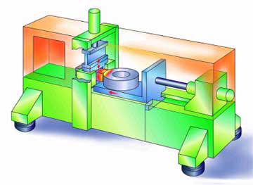

Workshop drawings of all modules of a prototype machine have been produced ( Fig.2), and the components are currently being machined or purchased. The prototype machine was trademarked LinFric TM by TWI [1] and has been designed to weld work pieces with a maximum weld area of 2000 mm 2 . The LinFric TM machine does not need any balancing, and its oscillator is driven by a hydraulic power pack through 8 accumulators, which can provide an oil flow of up to 750 l/min. It can vibrate at frequencies of 25-125 Hz with amplitudes of up to ±3mm. An axial force of up to 150 kN (15 t) can be applied during the friction phase. The force can then be increased to 200 kN (20 t) to permit consolidation during forging.

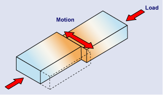

Linear friction welding ( Fig.3) can be used to join a variety of complex profiles. It is technically, commercially and environmentally a very attractive process, and is ideally suited to both mass production and to the manufacture of specialised components required in limited numbers. If different components have to be welded, only the tooling to hold the workpieces needs to be changed and different welding parameters may need to be developed.

Fig.1. Linear friction welding of titanium in normal atmosphere
Fig.2. Artist impression of the LinFric TM machine [1]
Fig.3. Principle of Linear Friction Welding
