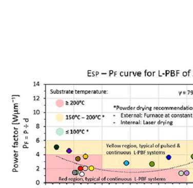

This case study presents a novel design approach developed at TWI to implement the PASSPORT solution in different vendors’ SLM machines. This approach consisted in using the power factor and specific point energy to characterise the SLM process. PASSPORT leveraged TWI unique numerical modelling and process monitoring for developing a more holistic process optimisation solution. TWI has been investigating geometry-specific process parameters to enable a near-uniform thermal history based in the process specific point energy.

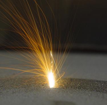

Fig 1. L-PBF process. Laser-material interaction
Fig 2. ESP – PF curve for L-PBF of AlSi10Mg alloy

The project successfully characterised processing parameters for part density and weld pool dimensions and quantitatively defined optimal processing windows. The project developed a new method for selecting process parameters based on an empirical laser welding model and offered a proposal to characterise the SLM process.

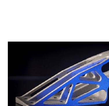

Fig 3. Topology optimised L-PBF component
