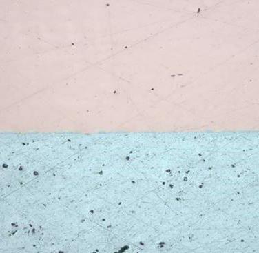

As the partners progressed the project over time, it became evident that the original idea for ColdClad of starting from the basis of a known TWI joining technique would not work as originally envisaged, probably due to equipment not being wholly large enough. However based on collaboration and innovative thinking, the two partners worked together to develop a rolled aluminium and copper bi-metallic strip (see Figure 1 below), with STL going on to create a new technique to enable the bonding of the two materials, and TWI providing specialist technical support.

Even though the diffusion bonding process investigated within ColdClad was not suitable for STL, the information gained during the project enabled TWI to develop an optimised set of parameters for joining aluminium to copper, with the capacity for further EV associated purposes beyond that of connectors. The new joint type that is now achievable is also suited to many different applications, offering significant future potential for both the project partners and wider industry.

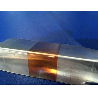

The work on the ColdClad project led to STL being able to create a proprietary cold-cladding process that they can now use to produce aluminium-copper bimetal strip. The foundation for this was the successful development of a bonding technique that overcomes the challenge of aluminium’s high reactivity to oxygen which makes it very difficult to bond cold (see Figure 2). In turn, this has great potential for industry, reflecting the radical changes in automotive technology and the worldwide transition to EVs usage.

Figure 1. Early micrograph showing a diffusion bonded joint between aluminium: Al1050 and copper: C11000 Cu, optimised to reduce intermetallic thickness whilst removing all pores.
Figure 2. Example of a bend testing coupon of a bi-metallic sample showing a copper inlay within aluminium.
