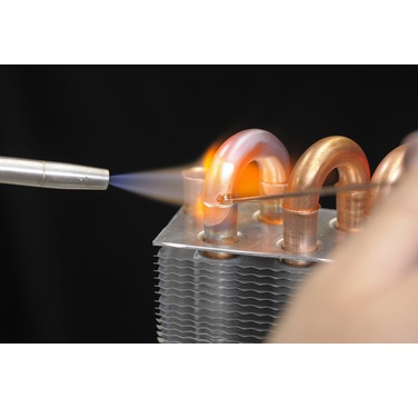

One such case study centres on the German company Webber, established around 35 years ago, which manufactures gas burners and gas-air mixing control systems for industrial use.  An industrial burner mixes fuel and air together, and uses an ignition mechanism, to provide a platform for combustion.  Webber products are not only installed as heat sources, but also as working flame burners (see Figure 1 example), where the flame shape and form is used as a tool to perform an operation within a production process such as flame polishing of glass and Plexiglas, and surface treatment of plastics prior to painting.

Example of the flame brazing process.
