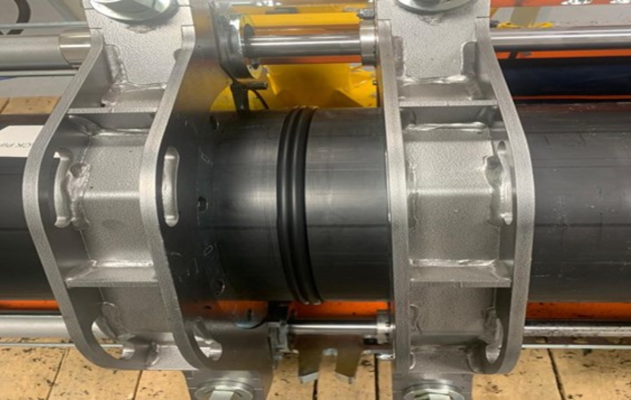

Heated Tool Welding
- Also called hot plate, butt fusion, mirror, butt or platen welding
- Hot plate temperature typically 30-1000C above melting point of plastic to be welded
- Can produce high-strength welds, easily automated, can weld some dissimilar materials using heated tools

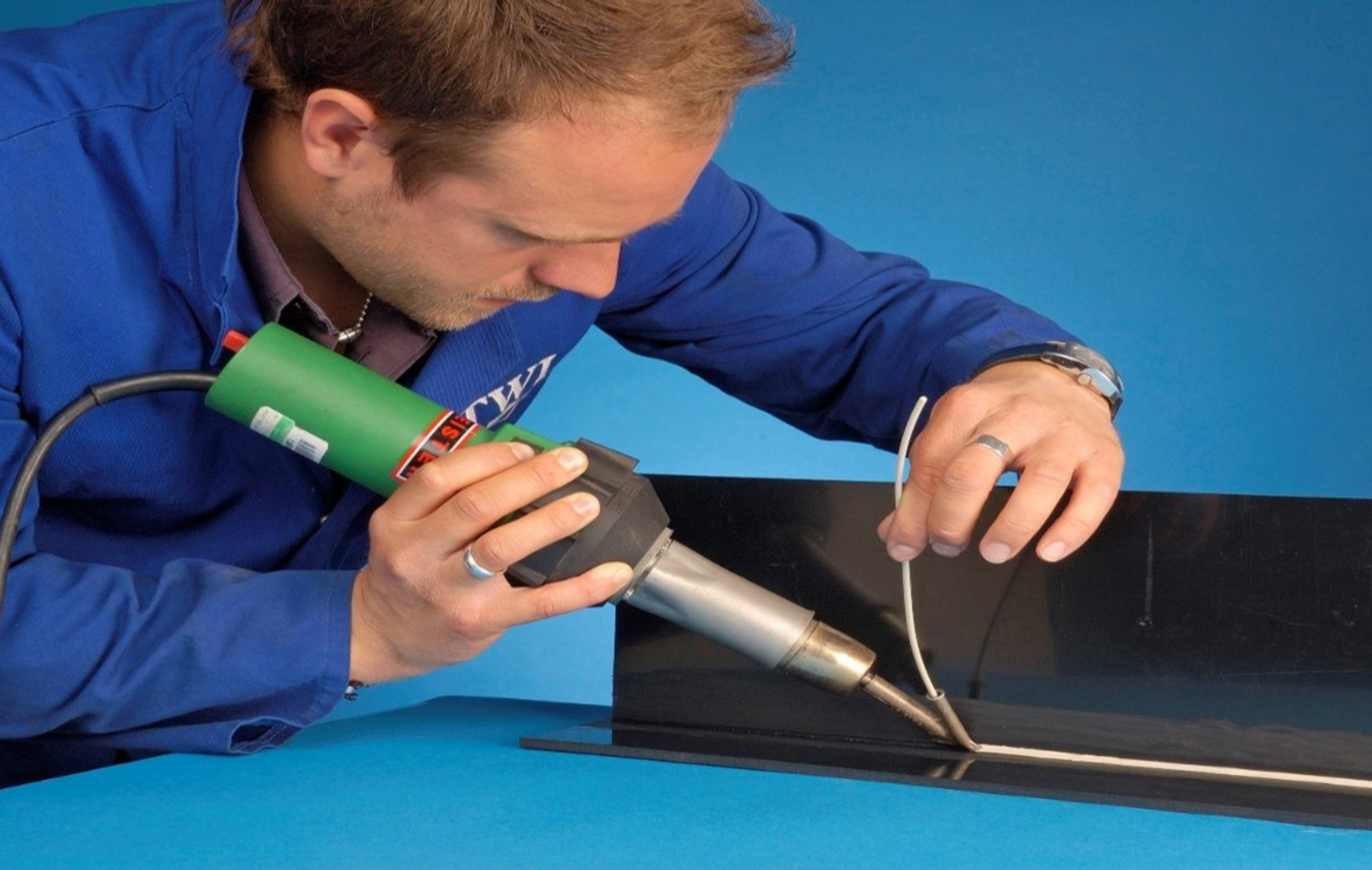

HOT GAS WELDING
- Manual welding technique where the weld quality is dependent on operator skill
- Uses a consumable filler rod.
- Hot gas temperature ranges between 250-4000C
- Weld speed: 0.2-0.3m/min
- Can weld almost any size and shape of component and low cost and portable equipment
Hot gas extrusion welding video

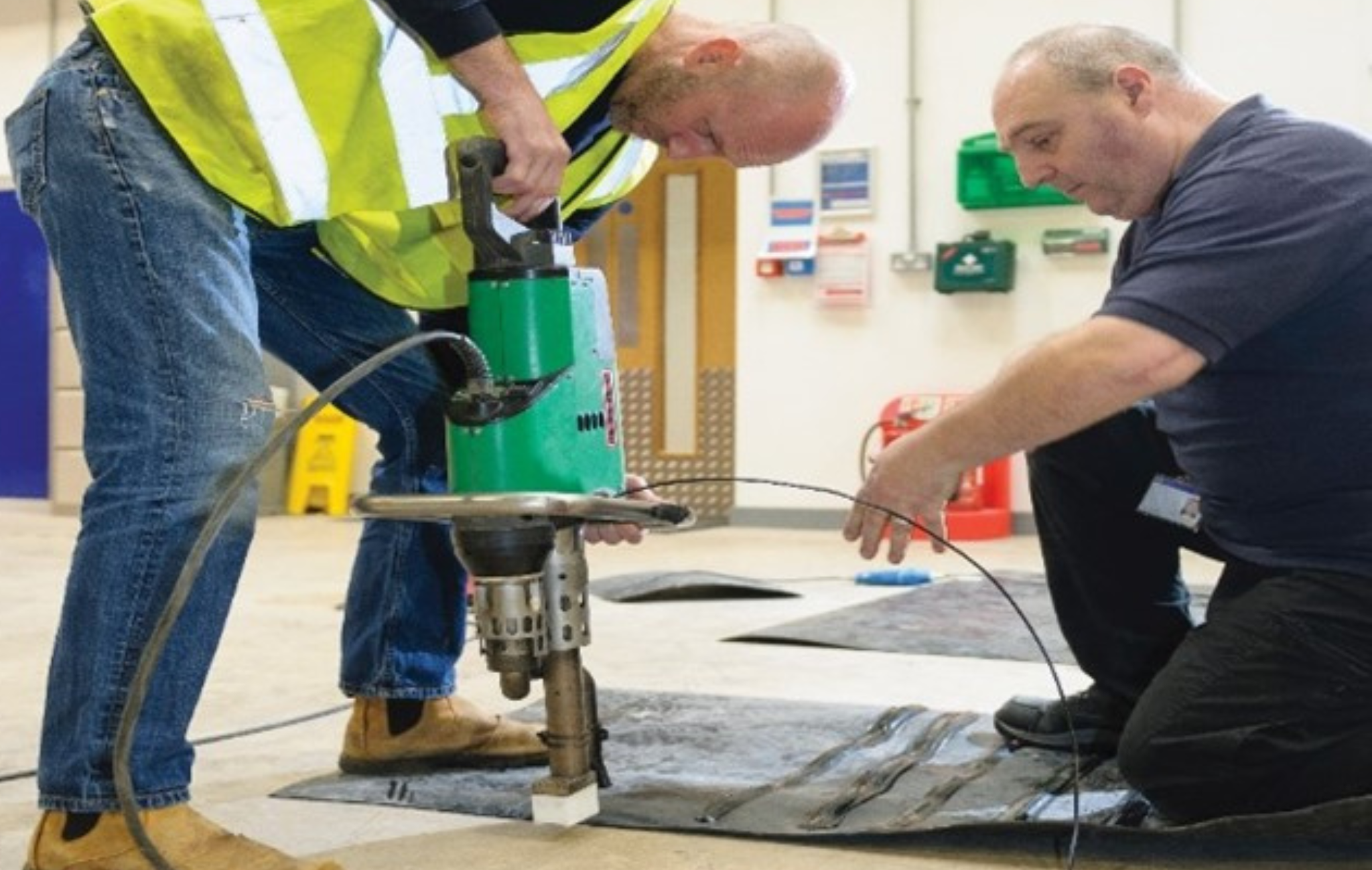

EXTRUSION WELDING
- Also uses consumable filler material
- Weld speed: 0.5-1.0m/min
- Joint usually filled in one passed and mainly used for PE and PP, PVC and PVDF as well
- Can weld large components, low cost, with portable equipment
- Faster than hot gas welding
Extrusion Welding
