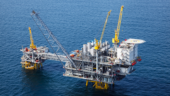

Many fixed offshore structures that are currently in use will either be decommissioned or face life extension. Most were constructed within 1960 to 85 before fatigue design codes had been fully developed to present high standards. Modern fatigue design codes are followed by offshore operators to form the basis for life extension developments of existing structures. But after analysis, many platforms show they have already surpassed their original fatigue lives. This leads to owners facing a high maintenance cost to continue their operation. Under another circumstance, if inspection results were to show that after a long service life, that a particular platform was still in excellent service condition, the question would be raised as to why fatigue analysis predicts such low fatigue lives. The main argument for this could be that more conservative parameters and solutions were used for fatigue analysis.

After analysis, some platforms are still found in very good service condition, so why did a fatigue analysis predict such low fatigue lives?. Photo: iStock
