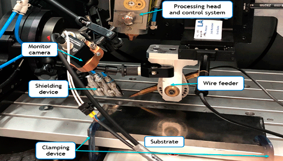

The final aim of this research is to create a dissimilar joint between composite and metal. In this case, the project consists of two main research progresses: laser metal wire deposition (LMWD) to build a solid rivet on the metal substrate, and dissimilar joining to interlock composite sheet to the metal substrate. The different metals (titanium, aluminium, and steel) will be used to create dissimilar joints with CFRPs after designing and developing the experiment. Several analyses will be conducted including, but not limited, to metallurgy, strength and fatigue tests. For the numerical analysis, an ABAQUS simulation of laser riveting will be applied in this project.
Fig 1.LMWD-processing-system-setup.

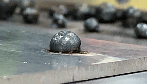

So far, the main investigation on the first research progress, LMWD, has been completed. This focuses on the cylinder building in three areas: wettability checking, feasibility study on Ti6Al4V, and parametres control both on 304 stainless steel and AA 60601 deposition. Some trials of dissimilar joining for steel to alumininium have been tested and analysed at the end of this phase. LMWD experiment processing system shows in Fig 1.

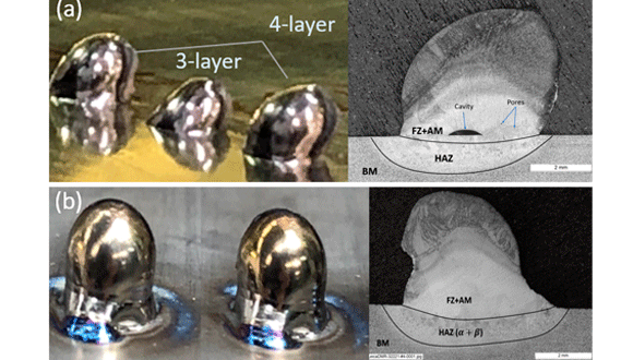

In the feasibility study of cylinder building, two different shapes were explored. In both cases, because of the limited deposition rate, one single layer of material was not sufficient to build a cylinder. Thus, each cylinder was manufactured by depositing a certain number of layers onto the substrate. Two different path strategies were adopted for depositing the material in each layer: the 3-arcs and full circle path strategies.

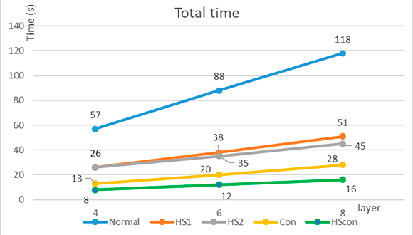

After the processing parameteter control and improvement trials of steel deposition have been conducted, targets on the key factor of industry-productivity-time shorten. Through the processing parameters control, different deposition strategies have been designed: high speed (HS) deposition by increasing the speed and reducing the cooling time, then a new continuous deposition method (Con) developed which removed the cooling step between layers. Results are compared in the next paragraph.

1. Feasibility check for cylinder deposition of Ti6Al4V:
Fig 2. Multiple layers Ti6Al4V cylinder deposited by LMWD applied with a 3-arc path and (b) full cycle deposition path.

2. Parametre control and improvement of stainless steel cylinder deposition:
Fig 3. Total processing time results from the comparison of different deposition methods.

3. Initial trials of dissimilar joining for aluminium to steel:
Fig 4. The dissimilar joint trial of steel and alumininium plates.

In the preliminary stage of this research, single layer cladding and multiple layer deposition experiments were conducted using 3-arc path and full circle path strategies respectively. Both results proved the feasibility of the cylinder building based on the laser wire deposition method in the micro-scale (circle radius from 500μm to 1.5mm).
Although, the multiple layers were successfully implemented in the two path strategies, the results still demonstrated flaws in the single cladding, and a build angle issue while building the 3-arc path layered deposit, Fig 2(a). This issue was solved by changing deposited mass, which allowed successful deposition of proper geometry with desirable microstructure, Fig 2(b).
In the multiple layer deposition of steel trials, several deposition methods were developed by adjusting different processing parameters, which include but are not limited to, power, travel speed, cooling time and deposition path strategy. The initial feasibility trial is refered to as normal deposition (baseline), which was used as the benchmark for deposition procedures in order to reduce the processing time. These included high speed (HS 1&2) and continuous spiral deposition (CON). The outcome was a reduction in the overall deposition time by 85%, while delivering similar mechanical and metallurgical benefits.
