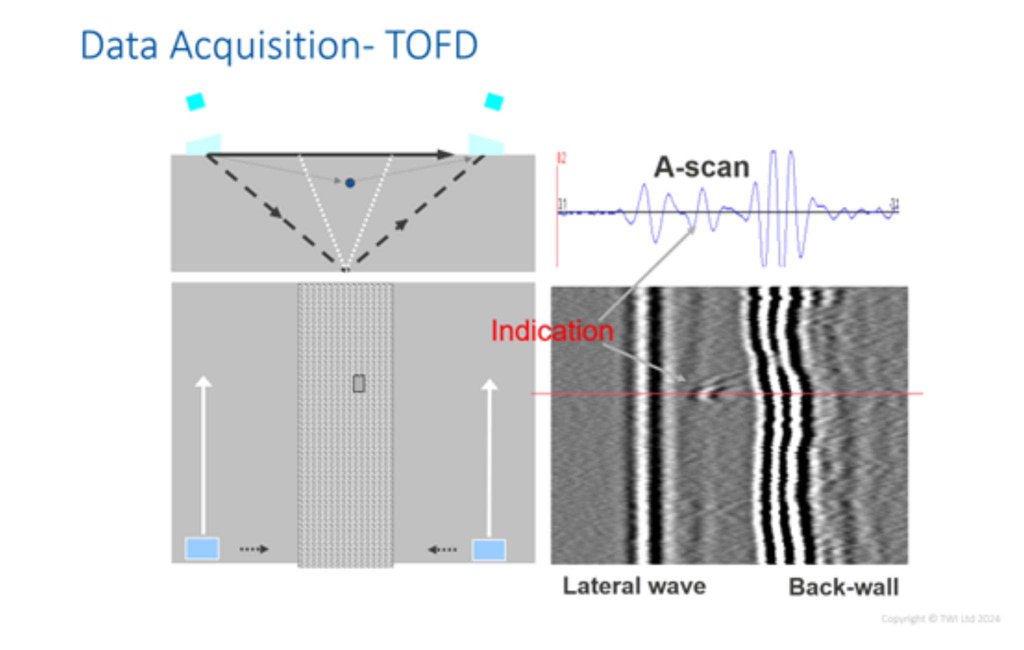

  1. TOFD Basics and Principles
The webinar began with an introduction to TOFD, explaining the underlying principles of this advanced ultrasonic method. Attendees learned about TOFD’s unique approach to capturing diffraction signals from the tips of defects, which enables accurate flaw detection and sizing, even in challenging applications.

  1. Data Acquisition and Analysis: Sizing Methodologies and the Phase Reversal Technique
The webinar delved into data acquisition and analysis, introducing participants to TOFD’s sizing methodologies. A focal point was the phase reversal technique, a powerful approach in defect sizing that provides clearer data interpretation. This phase analysis is especially important for accurately measuring the vertical extent of detected defects, which is critical in high-stakes projects where precise defect characterization is necessary.
