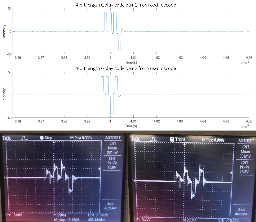

Golay code pairs with 4-bit length.

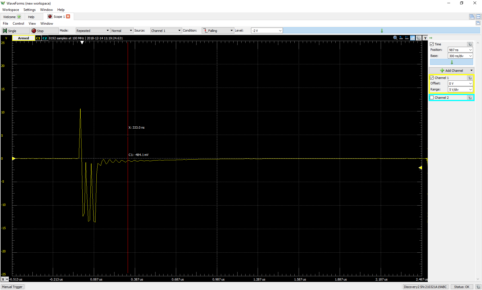

Four-bit 10ns pulse train width suitable for a 50MHz ultrasonic wave.
