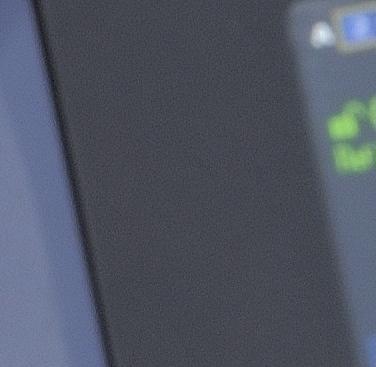

Phased-array ultrasonic testing (PAUT) procedure development
Solution
TWI developed a phased array ultrasonic testing (PAUT) procedure to enable volumetric inspection of the welds. Given the welds’ complex design, with asymmetric “TKY” type joints and a variable weld preparation, careful consideration of the inspection methods was needed. Several of TWI’s Level III NDT experts helped develop the technique to ensure that coverage was sufficient for all joint configurations and accurate indication sizing was achievable.

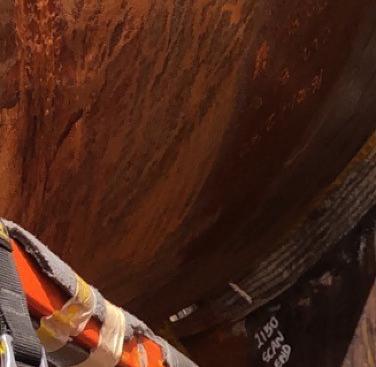

Ten personnel were deployed on-site for eight weeks, conducting the NDT at height. The inspection was carried out in two stages, the first for detection. Then, for indications requiring further evaluation, different focussing methods were used for more accurate characterisation.
TWI reported the inspections in the client’s required format and provided further contextual information and decision support when requested. This decision support was able to draw on TWI’s other technology services to provide insight into structural integrity queries. TWI’s efficient turnaround of inspection reports was crucial to enabling the client to keep to their project timeline.

On-site PAUT inspection
