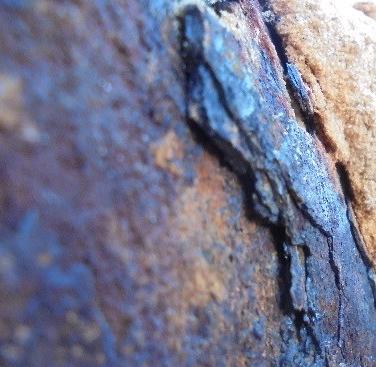

Figure 1. Typical overview of corrosion product at a test location.

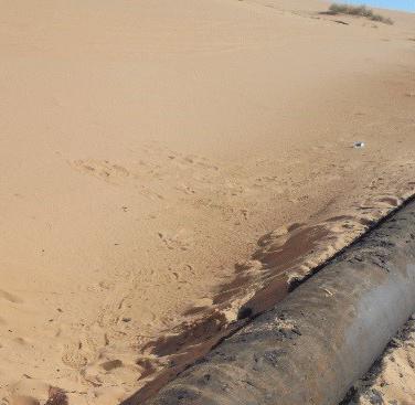

Figure 2. An example of an 18 inch trunk line which was inspected using guided wave testing.
Solution
Pi inspected the specified areas of the pipeline over a 30 day time period; 25 different pipelines were inspected spanning a distance of over 5,300m. The pipeline was challenging to work with due to having a variety of diameters (between 6 and 18 inches) and being in problematic locations, such as buried within shifting sand dunes or under road crossings. Two test locations were identified as having substantial pipe wall reduction; these were subjected to phased array ultrasonic testing (PAUT) and visual examination to gain further insights.
Conclusion
The project successfully detected corrosion at two different locations. The GWT identified changes in wall thicknesses, allowing the results to be categorised into different risk levels and assessed both visually and with data analysis software. Pi concluded the project with a comprehensive report for the client.
