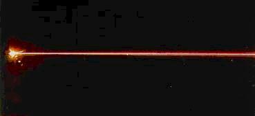

TWI has conducted extensive weld development studies using a 75kW EBW machine operated at a chamber vacuum of better than 5 x 10-3 torr. Some work has also been carried out on non-vacuum and reduced pressure (1mbar) electron beam welding of aluminium alloys, mainly to assess the potential of the processes.

Electron beam welding at TWI in reduced pressure atmosphere (gun on the left)
