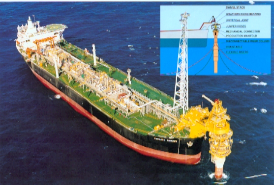

SBM had been commissioned to design and build a floating offshore production, storage and offloading vessel. This was to be used in the Wanaea and Cossack fields off NW Australia.

Courtesy of Single Buoy Moorings Inc – main contractor for the Floating Production Storage and Offloading (FPSO) disconnectable turret
